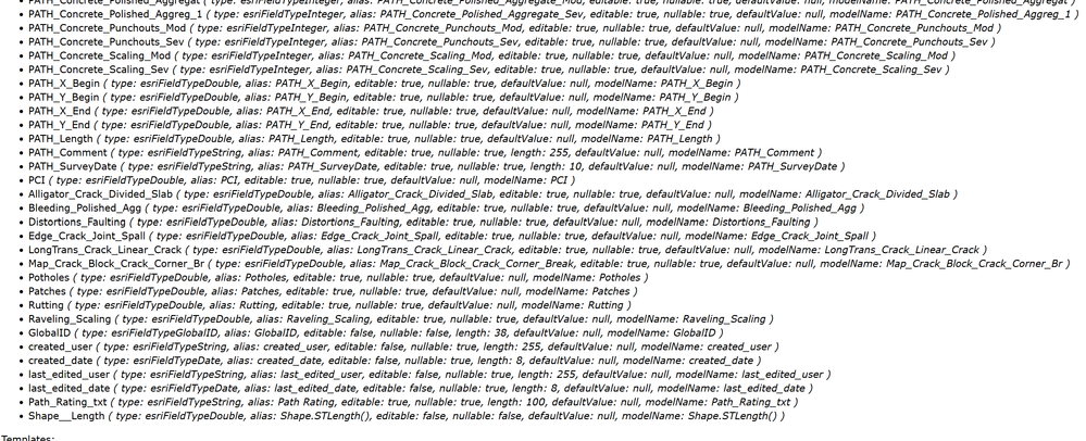

It is a portal item, I was trying to do a FeatureSetByPortalItem but keep getting the error:  Test execution error: ',' expected.. Verify test data.
I need to be able to acce the "Path_Rating" field and the "PATH_Length" field and I need calculate the "PATH_Length" field so that it is divided by 5280 to convert it to miles.

GaryMorris
I really appreciate your help.  I have tried to apply this and keep getting "Test execution error:  Invalid variable assignment.  Verify test data.
here is what I have put in:
