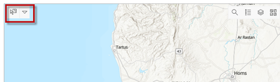

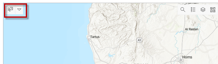

Hi, I have configured an operational layer to flash map when a feature from hospital layer is selected.
After configuration, selection tool is displayed on map window as shown
I activated the selection tool and clicked on a hospital feature on map, but the feature is not selected. Any ideas?
