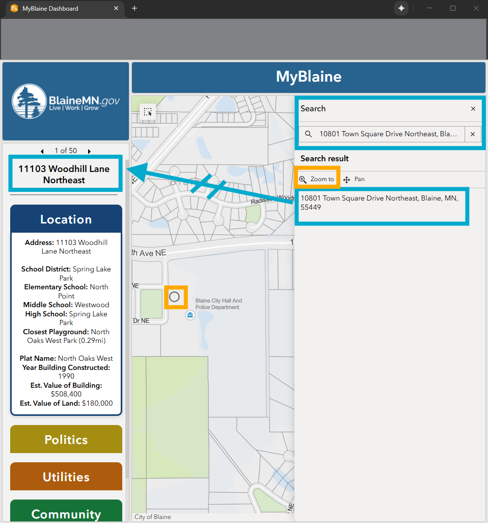

We are using Dashboards to build a utility for the City of Blaine, MN.
Goal: Using the search bar (which uses our custom city locator behind the scenes) in Dashboards, upon hitting <enter/return> or clicking on the found option, the address is SELECTED, causing the Details Widget to filter.
Currently, it will zoom to the found address but will not select it directly; the user needs to click on the map to select the parcel, populating the Details Widget.
Example:
Here it is giving a point on the map when you click 'zoom to' (yellow), but the parcel itself is not selected, so the details function just filters to the map extent, which means the addresses do not match and the results aren't accurate (blue)
Here is our Dashboard:

Neal_t_k
MVP Regular Contributor
Have you considered, instead of the search tool, make a new category selector in the header, and set that category to the address field  from you parcel layer with the search option turned on.  I am not sure there is a way to make a direct connection from the search tool to one of your layers.
You might need to make a new data expression to format the address to your liking.
Neal_t_k
Otherwise it appears in your webmap you can set the search to search a layer and it follows through to the dashboard: https://doc.arcgis.com/en/arcgis-online/create-maps/configure-feature-search.htm
You could set up the search in your webmap to search the parcel layer by address, this should make a selection that should trigger your other widgets.
MiaWhite34
You’re right—Dashboards doesn’t currently trigger a selection event from the search widget, only a zoom. A clean workaround is to use an ArcGIS Arcade expression or a Feature Filter action tied to the search result layer to simulate selection. That way, the Details Widget updates automatically without needing a map click.
