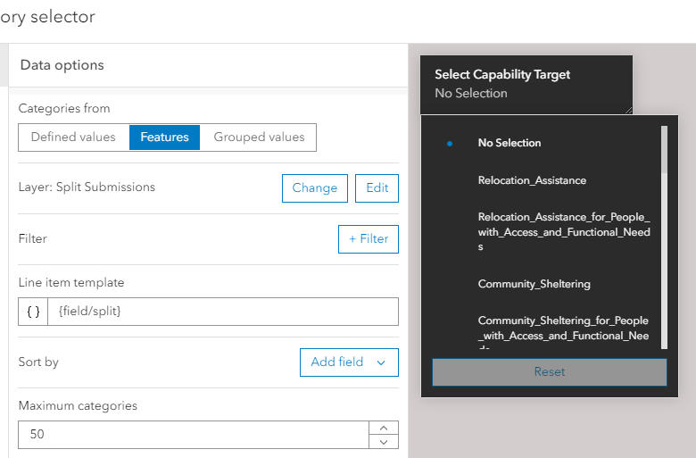

I am trying to remove the underscores from the split field, not all fields. I've been trying to do different things within my data expression but haven't gotten it to work yet.

Can you just replace the underscore before you add it to the dictionary?
  for(var i in split_array) {
    var newSplit = Replace(split_array[i], '_', ' ');
    Push(choicesDict.features, {"attributes":{
                                "globalid": globalid,
                                "Name": Name,
                                "Jurisdiction": Jurisdiction,
                                "Community": Sub_Jurisdiction,
                                "core_capability": core_capability,
                                "Target": Target,
                                "split": Trim(newSplit)}})

dwold
@KenBuja worked perfectly. Thanks!!
