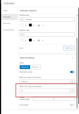

JenniferAcunto
On the Indicator tab of the configuration panel, expand the Value Formatting section. There you will see the option to set the minimum decimal places.
- Jen
