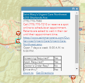

I have a webmap in which I've formatted the HTML pop-up as two tables.  In the webmap the pop-up looks fine and everything aligns left.  EVERYTHING in this pop-up is formatted as a table - even the top half that doesn't show cell boundaries.

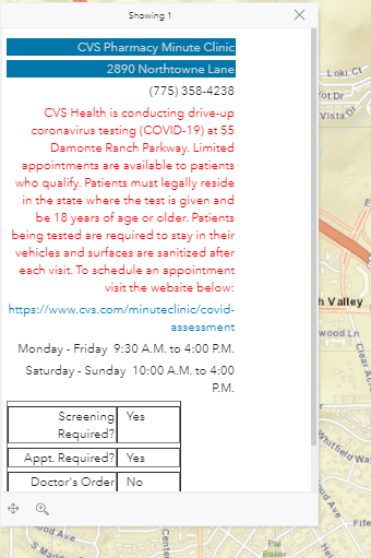

When I use this map within Dashboard, the very same pop-up behaves as right-aligned:
My pop-up HTML is attached.  I've shoved a bunch of left-align statements everywhere to try to force the behavior - to no avail.

I've removed the top part of the pop-up from the table and my left alignment has returned.  So I'm okay for my customer, but I really want to understand why that table went into a bad alignment situation, since putting everything in the table gives me a little more control over the popup.
BAD right-alignment popup dashboard:

Good alignment dashboard (not using table for top part of popup):

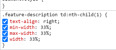

Hi @LisaBerry , Hi @JayJohnsonWashoeCounty
Do you have news about  this issue? I'm experiencing the same behaviour.
I've also a popup set with text-align: left, works fine in the webmap but looks aligned right in the dashboard.
When inspecting the pop-up in the dashboard (chrome devtools (f12)), I see a text-align: right
Let me know if you have an update on this.
Thanks,
Marcello
