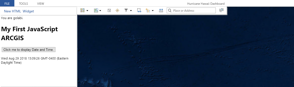

Hi,

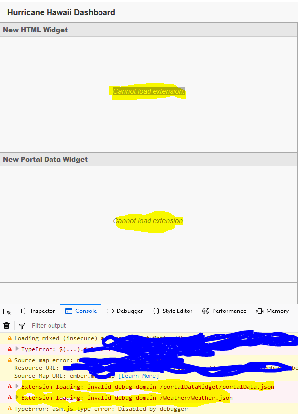

I add one simple widget on the Operation Dashboard and when I work with debug mode of the operation dashboard my widget is fine and works well, but when I go to browser and try to check it I get error and it could not show up.
Could you please help me publish my widget and use them on the client side ?
Thank you,
Ali
Widget on the Debug mode on the operation dashboard.
Address for this file is on the "C:\Program Files\ArcGIS\Portal\apps\dashboard\extension\Weather"
My Error :
AliAjami-Bakhtyarvand
I find solution, I should publish the widget on the portal too.
