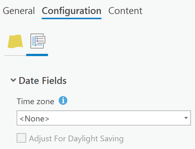

Ryan, the issue with the time stamp might be that most map and feature services use Coordinated Universal Time (UTC), which for me is 8 hrs beyond my local time zone. This pushes some records into "tomorrow". To resolve this, choose a specific time zone in the Configuration Options when publishing from ArcGIS Pro:

  I have tried playing around with that configuration feature.  The problem is we want to append data after the layer in published.  It seems using the append in model builder in Pro, when appending the time zones applied to the layer is ignored.
