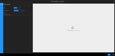

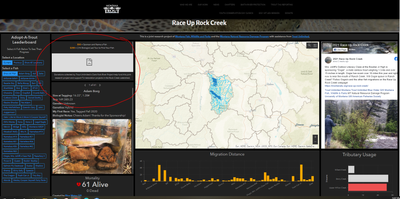

We have a (classic version) of an Operations Dashboard with an embedded content that is down - and I can't troubleshoot as to why.  The webpage of the embedded content is fine (https://bluewatergis.com/sponsor-a-fish-and-or-tributary/) and even  www.google.com and www.esri.com web addresses give the same error, so I feel like it's something with the dashboard side (versus our embedded web page).  It's unfortunately a very important piece of the dashboard - as it's the client's DONATE button!  Any thoughts are greatly appreciated and the live link is here:  https://montanatu.org/race-up-rock-creek/
Thank you!
Katie

I'm having the same issue with a document in my dashboard. It was working using the URL to the pdf (https://heller.brandeis.edu/mass-health-policy-forum/categories/mental-health-substance-abuse/pdfs/a...) and now it is saying blocked by Chrome. I posted the PDF to my AGOL account and shared the document with everyone (https://ntondpw.maps.arcgis.com/sharing/rest/content/items/347da4b3237d4f28b42dddbcd6154961/data). It still will not load when use the link from my AGOL server. I'm getting a CORB issue in my console along with this error:
crbug/1173575, non-JS module files deprecated.
(anonymous) @ (index):7146
I see your donate button is up and running again, congrats! Do you have any tips on how to get the URL working?
Nate
Northampton Health Department
KatieGaut
Hi Nate,
No!! I never did figure out what was going on and no one here on Geonet responded. I ended up taking down the embedded content entirely and put in an image with link. It opens a new window (which was what I was trying to avoid with the embedded content), but it's better than having no donate button at all for the project! Let me know if you get something figured out and good luck!

Hi @KatieGaut and @Anonymous User,
When attempting to load the dashboard with the embedded content, have you viewed the network traffic to help troubleshoot the issue? If you're unsure, please see this blog,
I wonder if perhaps the web page(s) you're trying to load have a security block (by design) to prevent them from loading within an iframe in dashboard. I suspect this might be the case for Katie's donate page.
