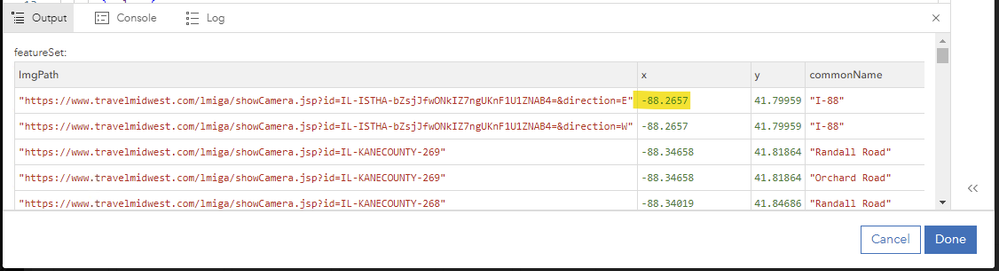

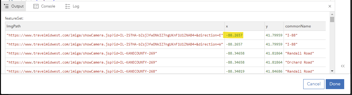

I've created a Data Expression that returns a feature set with several esriFieldTypeDouble fields.
When I run it in the Arcade editor, the Output looks correct, with all of the decimal places being preserved.

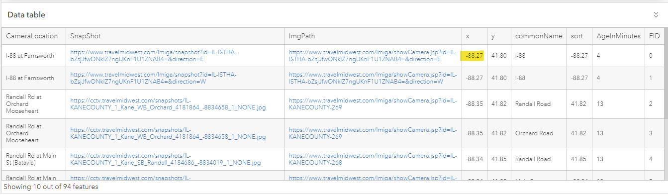

However when I view the Data Table in the widget editor only 2 decimal places are shown.
This is a problem because I am sorting on the Double field and the 3rd and 4th digit determine the sort order.
Is there a way to format the esriTypeDouble field so that it has more than 2 decimal places? I can probably perform the sort in Arcade but I would like to be able to use the Sort option in the widget editor.

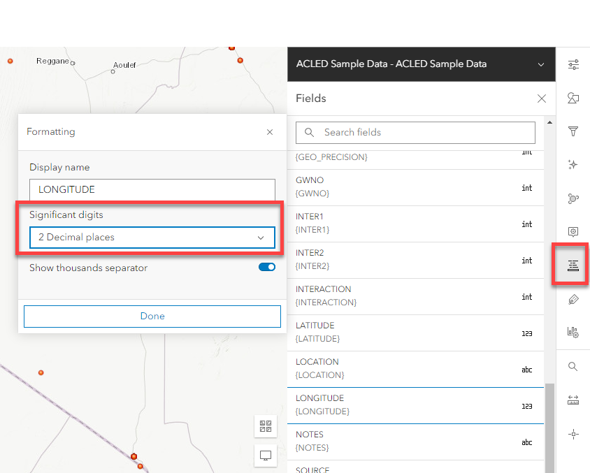

JenniferAcunto
You need to format your decimal fields to show the number of decimal places you desire. If you are bringing that layer into the dashboard through a webmap, you would do that in the webmap. If you brought in the layer directly, you would need to do that in the visualization tab of the item details.

I'm pulling in the data using the FeatureSetByPortalItem function, combining it with data from another item and then creating a new FeatureSet object from a JSON definition.
I'd be surprised that it would still be formatting the field based on the popup of the original item, since I'm defining a new field. I even tried giving it a different name. The JSON used to create the Feature Set includes the correct number of decimal places.
