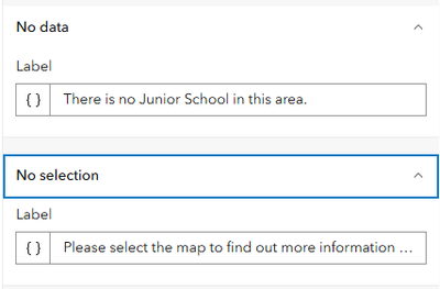

I'm fairly new to Dashboards so apologies if this is a silly question. I've read the 'Configure an element' docs about three times and I'm still not sure how this is supposed to work, or if I'm expecting the wrong things. This in particular:
  • No data—For data-driven elements, configure a label that displays when there is no data to render on the element. By default, an element in this state displays the No Data label.
  • No selection—When elements are configured to render only when a selection is made using the Render only when filtered option, you can configure how the element displays before rendering. By default, the title of the source element or elements from which selection is required is displayed. If the title is not available, the source elements name is shown instead.

I would expect that if a selection is made, but there is no data - because there is not a school for that age range in the selected area, that the 'No data' label would be displayed e.g. if there is no selection on the map all catchments say 'Please select the map to find out more' but if there is a selection on the map, but no junior school, it would say 'There is no junior school in this area'.
N.B. If I don't set 'Render only when filtered' it shows the first element in the unfiltered list which is exceptionally unhelpful because then it just always says 'XYZ Junior School'.
But that doesn't seem to be how it works, it only ever displays 'Please select the map to find out more.'

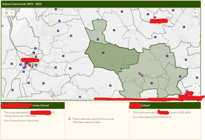

How are your catchment layers configured? In the screenshot provided, it appear the Junior Catchment is not  selected at all so you are seeing a not selected message.  Are all the catchment layers the same and overlap exactly and just have different attributes that indicate primary, secondary, etc. or are the like a puzzle, mosaic. i.e. Does the Junior catchment for instance have holes in it where Junior schools do not exist?

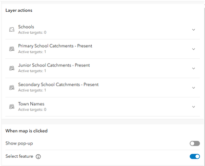

So on the map element's Layer Actions tab I have the below:

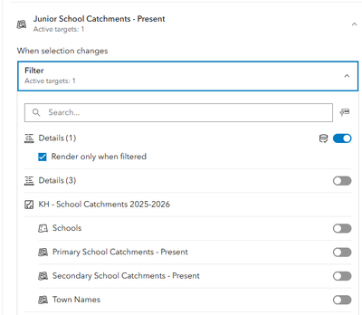

Then, on the specific layer, Junior School Catchments (there's always data for the other two layers, so they don't present an issue)  I have the below:
So when a situation like the below arises, where I have a primary school and a secondary school, but no junior, I would have expected to see the message 'There is no Junior School in this area'. Because there is a selection, but no data.

I think you've hit the nail on the head, those are empty spots in the junior catchment layer. I assumed that because a selection had been made on the map, but there wasn't any data (because of the empty spot), it would return the 'no data' message. But I can see now that because the junior catchment layer is empty in certain regions then the layer is not selected, and so it displays the 'no selection' message.
