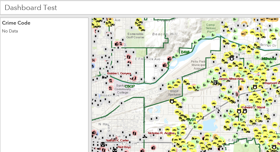

I'm trying to build my first dashboard. When I add a category selector I get "no data" and nothing appears in the selector, but when I click show data table it shows all of my data. The same thing happens when I add other widgets. The map widget appears to be working fine. Can someone tell me what I am doing wrong?NoDataShowPreview

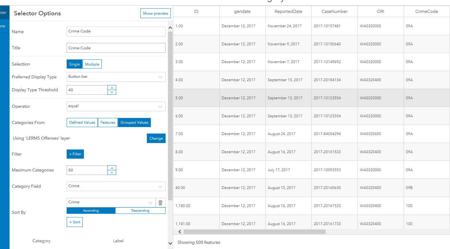

Hi Sonya,
Could you try removing the sort by to see if that makes any difference?
Does your data have any joins by chance?
Many of the other widgets including the category selector using Grouped Values, submit a statistical query to the service. The data table does not send a statistical query (which is likely why it works). Could you open the chrome developer tools, navigate to the network tab, type in "query" to filter network requests, could you then open the configuration for the selector? You should see at least query that should be specify "outStatistics" in the query. Can you see what the output of that query is?
