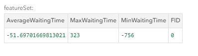

I have this code written in Arcade for a data expression to display the maximum, minimum and average waiting times of the most recent 4 years in 3 separate indicators. However, the time values that are outputted as a result of the code are negative. I'm not sure what's causing the negative values as I've looked through the code several times and there's nothing that looks wrong to me. This is what it's outputting.
I've even tried flipping date received with the well abandonment date in line 41 of the code and still got negative values.
Any suggestions to fix this?

Have you examined the data itself? You probably have dates that were added erroneously (wrong month or year), leading to those negative numbers. You could put in a statement like this to record in the console any dates that have a negative waiting time when you run the script in the editor
if (waitingTime < 0) console(`Feature: ${record.ID}, Date Received: ${Text(dateReceived, 'MM-DD-YYYY')}, Date Abandoned: ${Text(wellAbandonmentDate, 'MM-DD-YYYY')}`)

The data being entered is off a calendar option within a survey. The only way for the data to be wrong is if the date of abandonment is before the request date but from skimming through data it looks normal. I'll take a better look at the data to see if this is the case or not.

I updated my reply with some code that will write those negative wait times to the console.
Jabousaw
I got an error when adding the line of code but I found the issue causing negative outputs. There was some bad data. Thanks again for all the help!
