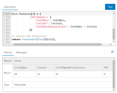

Below an example of the featureset that will be returned using some random values for the counts:

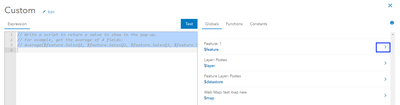

Good question... Normally, when you edit an Arcade expression you will have access to the properties and the easiest way is navigating the interface to use the relationship. Let me visualize this.
In the expression editor you would find the $feature on the right and you can enter and find all the fields of this $feature (click on ">" in blue rectangle):

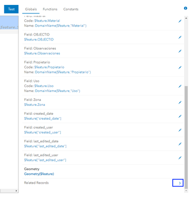

Next, at the end of the list of attributes you would find "Related records" and you can see all the relationships (click on ">" in blue rectangle)
This will show the relationship and when you click on the "FeatureSetByRelationshipName" link it will be correctly inserted in the code.

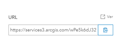

However, since you access the data in the data expression using the "FeatureSetByPortalItem" you will not find those options in the interface.
You can go to the details page of the hosted feature layer and open the REST end point:

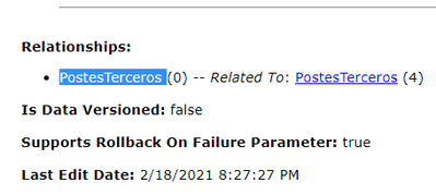

In the REST endpoint page at the end, you will find the relationships section with the name of the relationship:

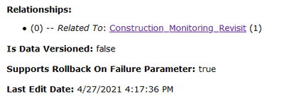

Ah I see. I am perplexed by my data. This was created via Pro with a named relationship class based on GlobalID/GUID, however this is what I see via the REST endpoint. I would have expected to see the relationship class name that I defined in Pro before I published these data to ArcGIS Online.
Out of curiosity, I added this layer to a new map and went into the pop-up to add a new expression. I clicked through $feature like you mentioned, found related records at the bottom and then clicked FeatureSetByRelationshipName to add it into the builder window. This is what I see.
FeatureSetByRelationshipName($feature,"")
Here is the Arcade I attempted...I am now getting the "Unable to execute Arcade script" message again, even though it returns the correct number of records when I click "Test":

That is interesting. It returns the correct value, but it does show an error. Maybe the name for the relationshipclass that should be used has to be "Construction_Monitoring_Revisit" (I am not sure). The best way to validate this is to add the layer to the map and use the navigation in the interface when creating an expression as described earlier. Just to be sure that you are using the correct name.
I am also wondering if it is enough to return the count as a number or that a featureset is expected. I think the latter. In that case, you could use something like the expression below.
