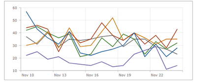

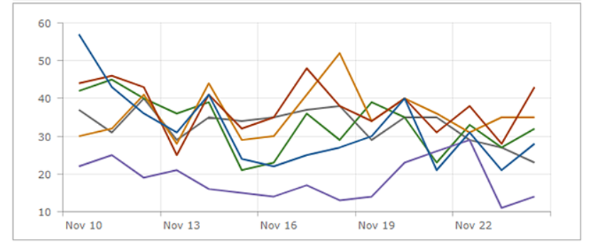

Trying to build a Serial Chart with three Axis --
The vertical Axis is Temperature in degrees F. The horizontal is Time and there are five stations reporting, so five colored lines..

Try this:
   In the Data tab of the Serial Chart, group by date and split by reporting station. Set the statistic to high, avg, or low and the field below the statistic to temperature.
   In the Series tab, set stacking to off (the default) and type to Line (or Smoothed Line).

I almost have this working, Support is looking at an issue where the Filtering by Date/Tiime seems to be broken.  But following your suggestions and then setting the Data Points to correct values the lines do plot as I hoped they would, although the time slider/filter is not what I expected here maybe it will work better when support comes up with an answer.
