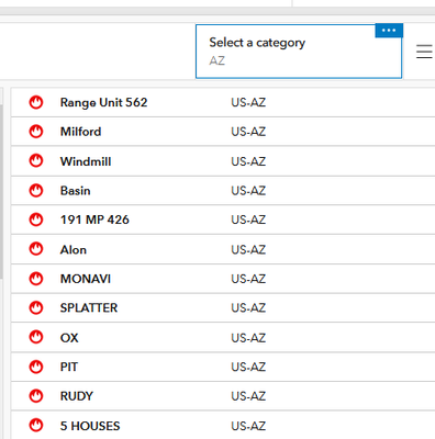

I'm having trouble getting a dashboard with a dropdown state selector to filter a wildfire label.
The dropdown uses standard state abbreviations (AZ/AK/AR, etc) while the wildfire layer has for some reason decided to name them US-AZ/US-AK/US-AR.

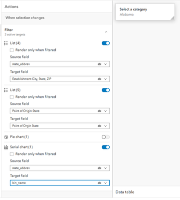

Oh, that's no good. If you need your selector to act against multiple data sources that have conflicting values, it gets messier, maybe impossible. But I think we can still do this.
Here's an idea: set the selector to Features, not Grouped Values. Since we have one entry per state, it's fine. On the Features setting, your filter actions can use different fields.
If we amend that expression to include things like the state's proper name, abbreviations, etc., we can filter different widgets on their appropriate fields.

The end result is a selector that can behave differently to accommodate the layer it's interacting with. What do you think, will it work?

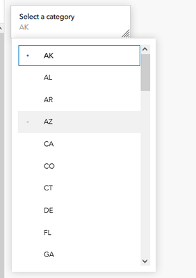

So is the issue just that you don't want the "US-" part in the dropdown? You can do it with a data expression!
It's kind of goofy, but trust me, it works. By creating a field with a domain, we can tell it to associate the 2-letter abbreviation with the US-**unspecified** format.

 Then set your selector to Grouped Features with that as your Data Expression. The selector shows the name, but it acts on the code. I included the US-**unspecified** code on my list to show.
