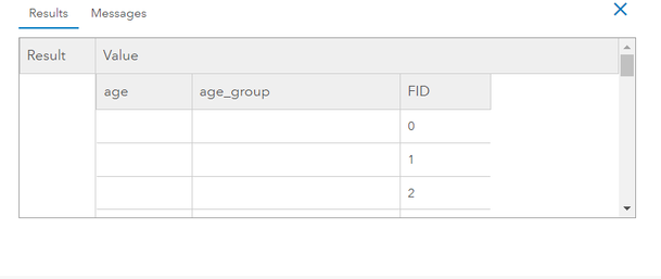

I have just started using arcade, I'm attempting to create a dictionary so I can reclassify the ages into groups (from a hosted feature layer), but my dictionary comes up empty. Below is the arcade code:

When I test this, the result looks like this:
KenBuja
MVP Esteemed Contributor
You have a typo on line 25 "attirbutes" instead of "attributes"

MlondiNdlovu1
Thank you. I did not notice. fixed!!
