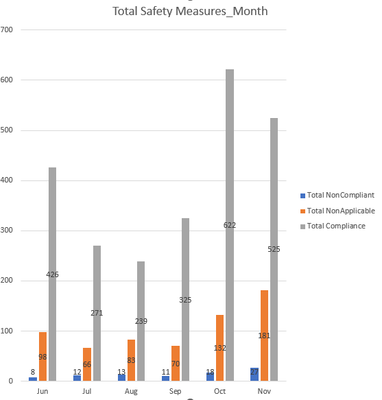

Hello,
I was wondering if this type of chart was possible using data expressions in Arcade.

In general, yes. Data Expressions are really only limited by how complex an expression you want to write and how long you're willing to wait for it to execute.
What does the data look like, though? I don't see anything about the chart you've posted that wouldn't be doable in the out-of-the-box options. If Compliance is a field in the table, you probably don't need a Data Expression for this.
- Josh Carlson
Kendall County GIS
DonovanC
I've attached the survey123 and the schema of the data. In the form users select Satisfactory, Non-Satisfactory or N/A for four sections. The chart I posted came from an excel sheet that the business group is hoping I could replicate using dashboards. I've experimented with the out of the box solution and could not achieve the same results.

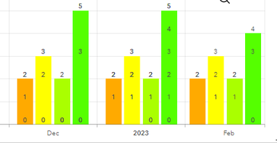

Thanks Josh this worked great, the data expression is awesome and has given me some ideas. But I'm guessing its a limitation with charts in dashboards I was hoping to have multi series grouped value chart using the date as a category field or would that be a totally different expression?
jcarlson
MVP Alum
Easy enough! Just include the date field in the groupby function, and that should make it available as your category field.
- Josh Carlson
Kendall County GIS
DonovanC
Hi Josh,
That worked perfectly as well. I'm not sure if its a limitation with the chart capabilities in Dashboards but can a Grouped Value chart display multiple series while using the date as a category.  I found when use the Features chart it ends up looking like this. Instead of showing each feature I would like to see the totals per month
