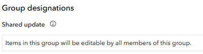

Hi Liam,
This is possible.  When you create the Group check on the option All items (group membership is limited to the organization) under the section What itmes in the group can its members update:
What this option does:  Group members can update any items shared with the group, which includes modifying the item details and updating the content. If you choose this option, the group becomes a shared update group, which limits group membership to members of your organization who have privileges to create, update, and delete content.
When you share content, be sure to choose the option Access and update capabilities:
You will see the group you created with the above option.

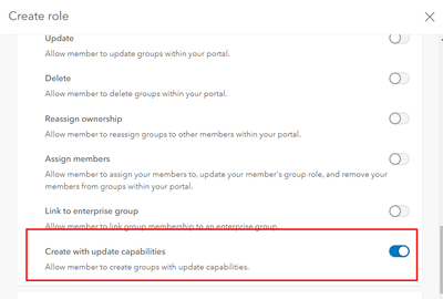

JayJohnsonWashoeCounty
I do not see the highlighted option when I create a group.  My role is Publisher.  Can you confirm that I have to be an Administrator in order to have that option available during Group creation?  Thanks.

MohammedElsayed
Hi @JakeSkinner I do not see the highlighted option when I create a group.  My role is Publisher. and I am working on kubernetes enterprise portal. do you have any clue regarding this issue?
Joshua-Young
MVP Regular Contributor

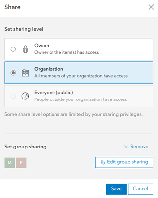

It appears the UI has changed at ArcGIS Enterprise 11.4. I have Shared Updated enabled for a group, but when I go to share my dashboards there is no Access/Access and update capabilities open. I share the dashboards to the group, but group members can only view the dashboards.
I get a box that looks like the image below. There is no share with update option that I can find.
How do you allow multiple dashboard editors at Enterprise 11.4?

@JakeSkinner never mind, the option to edit is there but the edit button is only available on the dashboard's item details page. We were looking for the pencil icon on the Dashboards home page or the Edit Dashboard on the group's content page.

@JayJohnsonWashoeCounty @MohammedElsayed
Yes, you will have to be an Administrator, or you can create a custom Role with Admin Group privileges:
