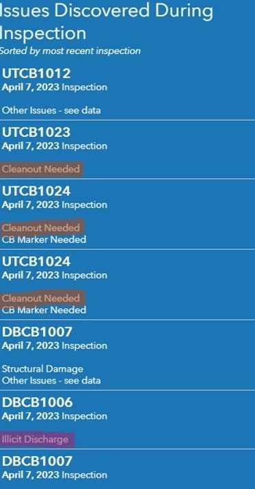

I'm trying to using a single when statement to change the background color of a list element. My arcade returns no errors but work as expected. Here's my code sample:

ZacharyStanley
Thank you! That approach works fine but I actually want to change the individual elements of the background color as show in this image:
Any ideas?

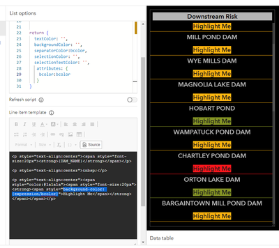

JenniferAcunto
It sounds like you want to change the background color of your font. You would need to use HTML to do that along with your Arcade. Add your color to the rest of the attributes instead of trying to force it into the background color section of your return statement. Then in the rich text editor for your list, add a background font color to the desired text element. It doesn't matter what color you pick.
Then go into the source to view the HTML, replace the hex code in the HTML with your Arcade color attribute.
This post walks you through how to do this for a table background, but the general process is the same.
- Jen
