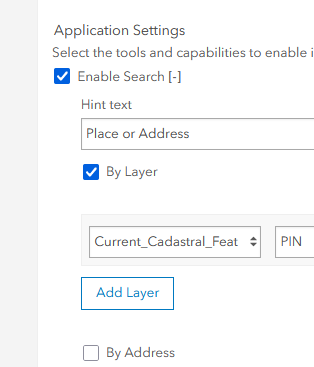

I don't know what locator you want to use, but is it possible to include a feature layer in the map and have it toggled off?
A map can also let you disable all locators. You could have your locator features listed under "by layer" and then disable all the built-in locators. Hacky, but it could work.
You can see in the map JSON that the "by address" setting is disablePlaceFinder. So it really is just a boolean, all-or-nothing for locators. When I adjusted the settings, the JSON suddenly appeared.
"applicationProperties": {
        "viewing": {
            "search": {
                "enabled": true,
                "disablePlaceFinder": true,
                "hintText": "Place or Address",
                "layers": [
                        "id": "Current_Cadastral_Features_294",
                        "field": {
                            "name": "pin",
                            "exactMatch": false,
                            "type": "esriFieldTypeString"
                "tables": []
- Josh Carlson

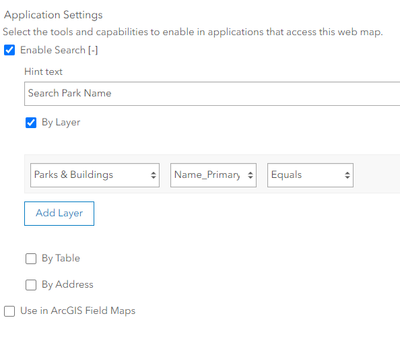

ArmstKP
@jcarlson My webmap and dashboard are public.  When I add a search layer and then turn off "By Address"  I still get the ArcGIS Geocoding Service in the search.
WEBMAP SETTINGS:
DASHBOARD SEARCH:
jcarlson
MVP Alum
That is beyond strange! There's nothing in the dashboard settings to store any kind of override, just "can this search". I know that adding layer searching to a map carries through to a dashboard, but how can it selectively ignore other settings?
Obviously, this needs some work. If you post an Idea for "overhaul search configuration in maps / dashboards", I'll totally vote it up.
