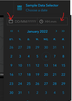

I understand that Web AppBuilder Dashboard Theme is being used, but in ArcGIS Dashboards, you can configure the Selector to allow date inputs by typing.
Date-based filter conditions—ArcGIS Dashboards | Documentation

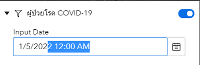

Alternatively, would you consider to use ArcGIS Experience Builder, the next-gen App Builder? As this also supports typing in dates with the Filter widget.
Filter widget—ArcGIS Experience Builder | Documentation
