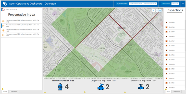

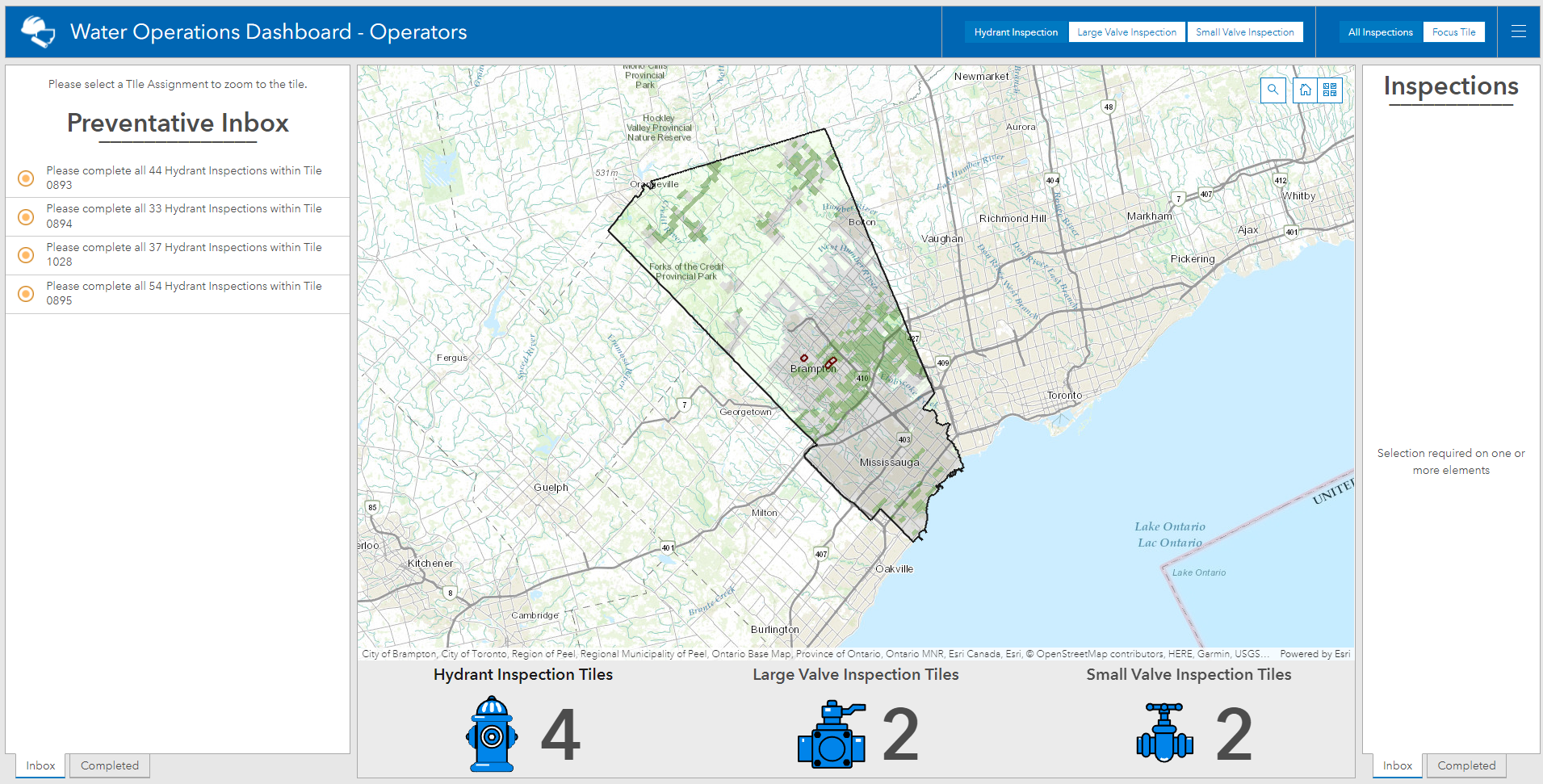

1. Operators in the field have individualized dashboards of their work using URL Parameters:

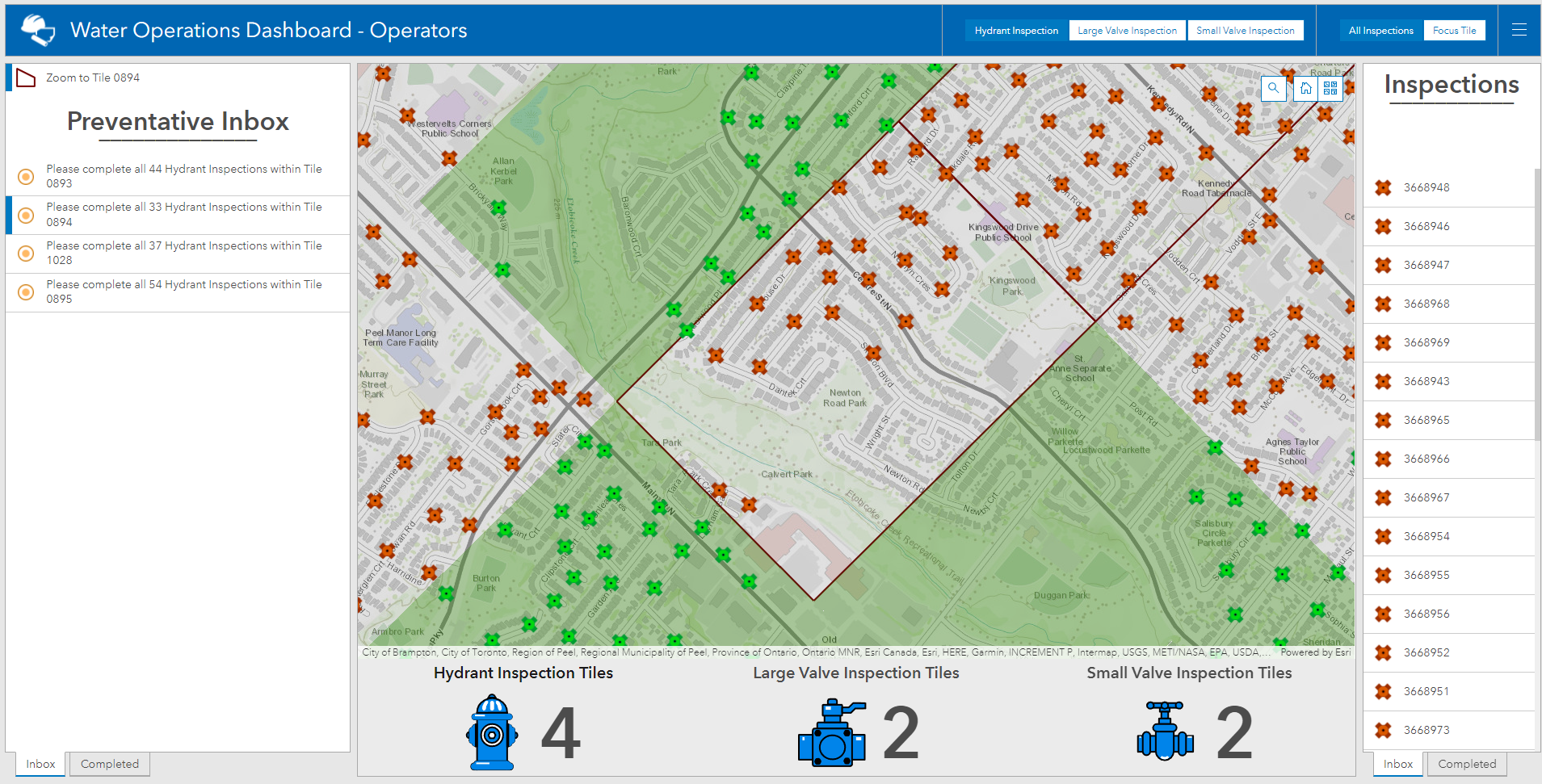

2. Operators can click on their list of work to do and zoom to the Tile with the associated Inspections:

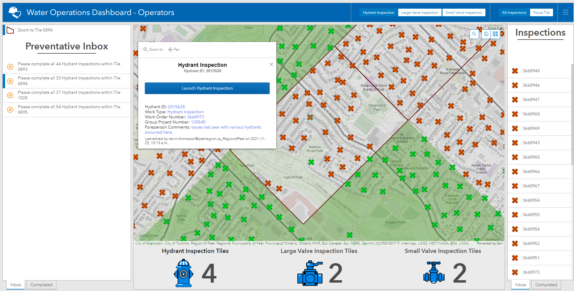

3. Operators can click the assignments and launch their inspection forms using the link to Survey123:

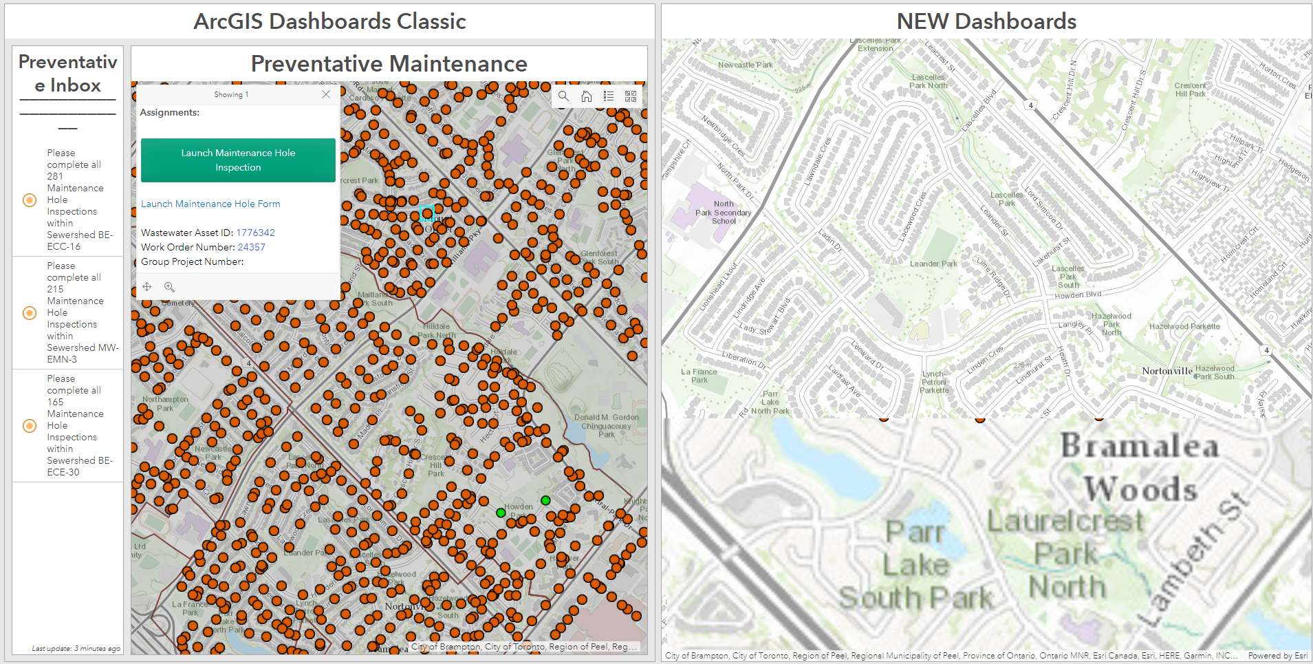

Here is what happens when you go offline:
ArcGIS Dashboards Classic:
- Popups could be opened & Survey123 could still launch (So long as the link did not require Arcade)
- Map could be panned and all data would remain within the extent that was loaded when previously online.
(Arcade must not be used or link would not open)
(Zooming must not be done as the data would be unloaded)
ArcGIS Dashboards:
- Popups cannot be opened in general
- Map cannot be panned without loosing data
