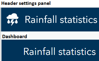

Hello everyone,
I've been using dashboards for a while now, without problems (ArcGIS Entreprise 11.0). I like to use default icons proposed by ESRI as logos for my thematic dashboards.
I'm not sure if this happenned after 11.0 update, but those logos do no display anymore on the header. Default icons are used, default color as well. I also tried different sizes and colors. It displays well when I configure it in the header settings, but it is transparent on the dashboard itself. Have you experienced such issue ? Thank you in advance.

For information, I had a look with technical support. It's working with third-party custom png files, which is an acceptable workaround for now. A bug ticket was submitted.

Hello @Arnaud_Leidgens ! Do you happen to have the bug number for me so I can add my own case to it? Facing the same issue. Funnily, while editing I can see it but as soon as I leave edit mode it disappears.
