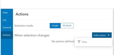

That is strange. inserting advanced formatting should not limit the actions for a widget. Can you share a screen shot of what you see, when you're in the actions section of the list.
PSGeo
Hi,
I made some testing and I think that is related with a creation of the expression: Data/edit data expression.
when I have the an expression defining the list, it rules out all the other actions except for the filter.
When there is none, all the actions are available.
Could it be a bug? I am using the ArcGIS Enterprise 10.9.1
cheers
KRankin
Ah yes, if you're using data expressions then that would limit your actions ability to filter only. Not a bug, it happens on my end too (i'm not using enterprise).
