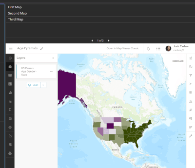

You can't really do this with a Map widget, as the widget will have a fixed source. You could, however, use an Embed widget. Together with a Data Expression for your list.
Create a list and use the following Data Expression. Extend the features array and adjust the map names and itemIDs as needed.

 Then you can configure your list to show the map name.
Next, create an embedded content widget, link it to the same datasource, and set the URL to
https://arcgis.com/apps/mapviewer/index.html?webmap={itemid}
Don't forget to add a filter action to the list! Now click your map list and watch the embed update!
You'll notice, of course, that the whole interface needs to load for each map, which could be jarring. You might not want the menus to appear. I'd suggest wrapping each map in a Minimal app or something, and using the embed to display those instead. You could also adjust the expression to hold the entire URL, in the event that not all items are in the same type of app.
