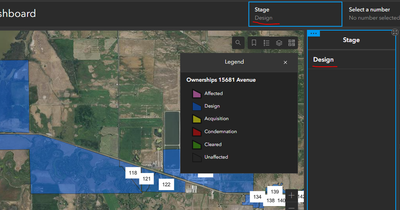

Hello,
I am currently working on a Dashboard, and I am having an issue with the legend showing all of the items inside the map rather than only showing the items from the feature I have selected in the selector. I have the selector set up so that whatever feature is selected that feature is only shown in the map (Render only when filtered). I know when I choose to hide stuff in the map the legend updates, but I want the legend to update automatically when I choose a feature from the selector. Is there a trick that will allow me to set it up this way?
Thanks in advance!
AdrianWelsh
MVP Honored Contributor
Chrystiana,

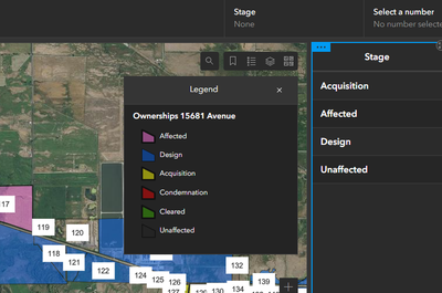

That is a great question. I tried messing around with a few things and I could not figure out a way to get my legend to update based on a category selector or selecting items on the map. The closest thing I could do to cheat this system is to make a Table element with my 'legend' items and filter that way. But, that is not a suitable replacement.
Without filter:
With filter:
In any case, I feel like this would be a great idea to submit to ArcGIS Ideas.
