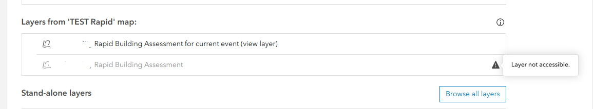

Hi,
I have a hosted feature layer called building placards in a map.  When I create a dashboard and add in the map the layer is visible on the map however when I try to add in a list widget based on my hosted layer it says the layer is not accessible.  I also have a view layer of the building placards hosted feature layer which has a filter for just a specific event date.  If I add in the view layer, this layer is accessible.  So the original hosted feature layer is inaccessible but the view layer is fine.  Anyone have any ideas?

Sounds like that layer does not have query enabled.
Dashboard Data Sources: Layer Capabilities
- Jen

Hi,  Thanks Jen,
That was exactly it.  This post also was helpful to remedy the situation. Thanks.
