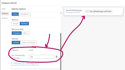

JonathanMurphy2
The most recent update to Dashboards breaks the custom label for category selector. https://doc.arcgis.com/en/dashboards/latest/create-and-share/selectors.htm

Hi, we are experiencing the same issue after the latest ArcGIS Dashboards update. Before the update, the category label overrides worked as expected.
Now the category label overrides in the Category Selector are being ignored. The selector still displays the original category values instead of the custom labels.
The issue also occurs when adding a new Category Selector or creating a new Dashboard, so it does not seem to be limited to existing dashboards.
