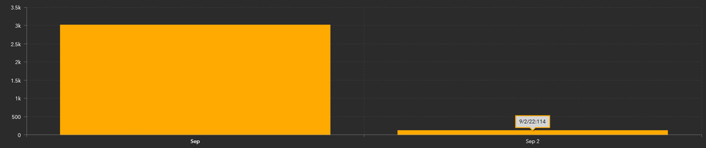

Although my code works I don't get the expected result since the dates that I generated are setted as GMT-5 and this affects the period that I looking for, getting "x" rows for the requested period and "y" for the 1 hour difference.
Console messages:
//2022-09-01T00:00:00-05:00
//2022-09-01T23:59:59-05:00
CharChar
As I mentionated the expected result is data only for September 1. (Is september 1 when I'm publishing this post.)
Researching I found that Arcade works with the local time zone but my time zone is GMT-6 just like my service, knowing this, Is there a way to asign the time zone as parameter of the Date function? and why the arcade time zone is different?
