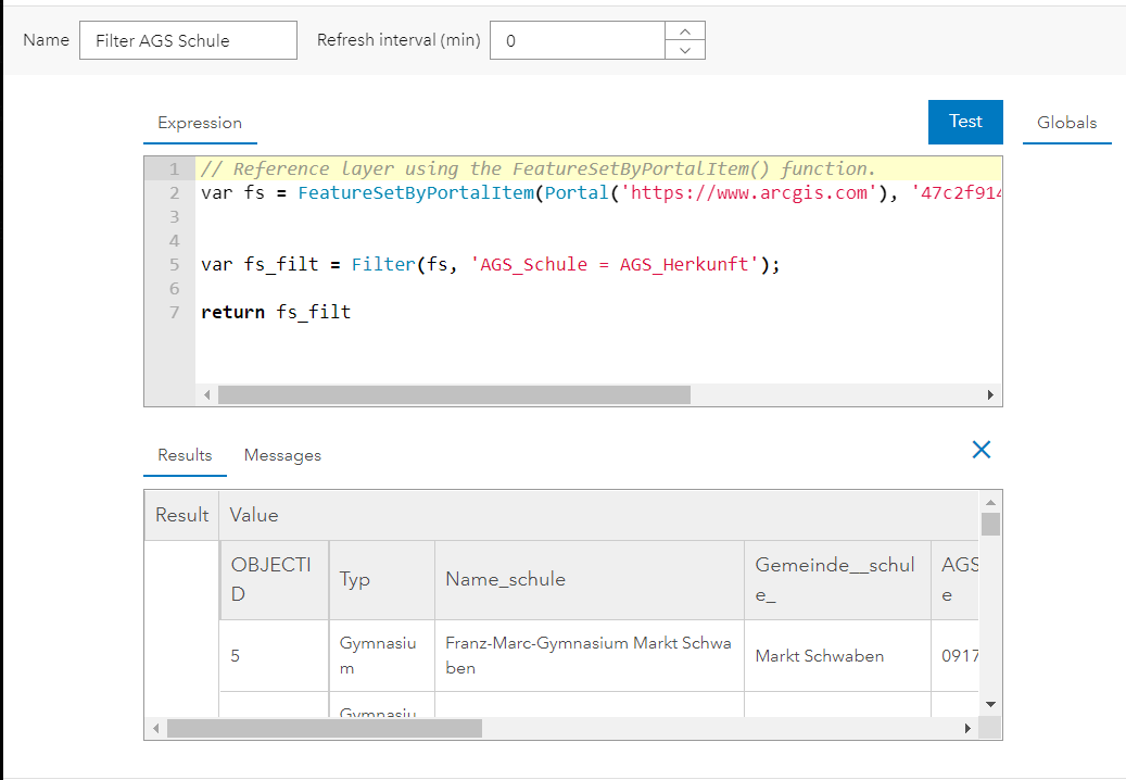

In fact the exact contrary of this:
The indicator can read this conditon and brings the data where the 2 AGS Postcodes are identical:

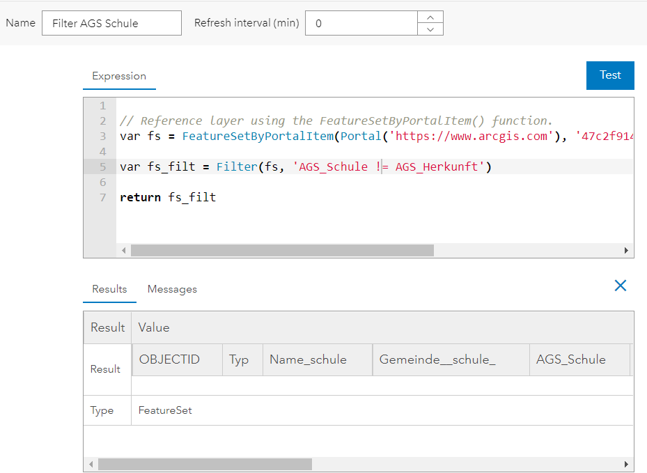

But when I write var fs_filt = Filter(fs, 'AGS_Schule != AGS_Herkunft') I do not get a usable FeatureSet, or at least it seems to be empty. And I am sure there are 200 records that meet this condition.
The indicator cannot read this expression:

Filter() uses a SQL expression. In SQL, the test for unequal is "<>".
var fs_filt = Filter(fs, 'AGS_Schule <> AGS_Herkunft')

DoZ
Hello Johannes.....
well, thank you! It worked!
