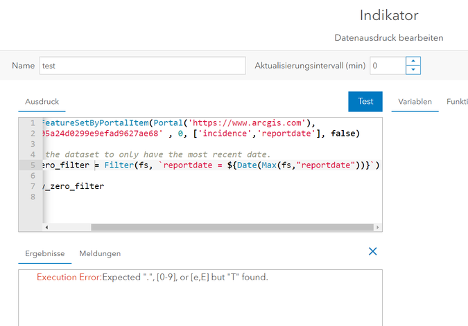

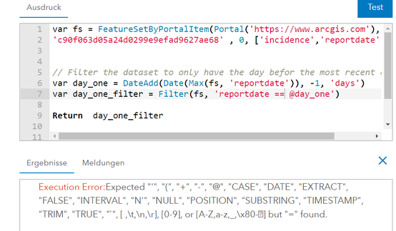

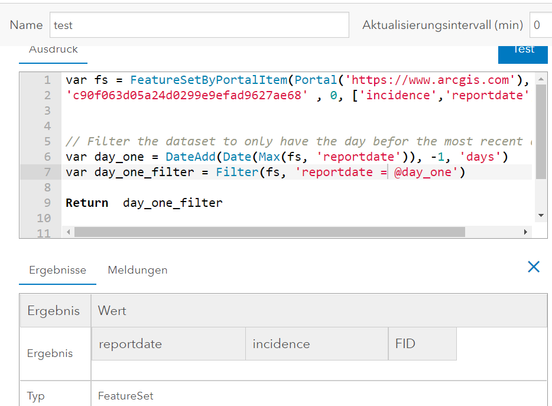

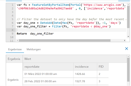

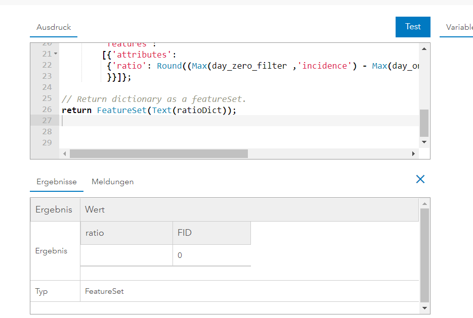

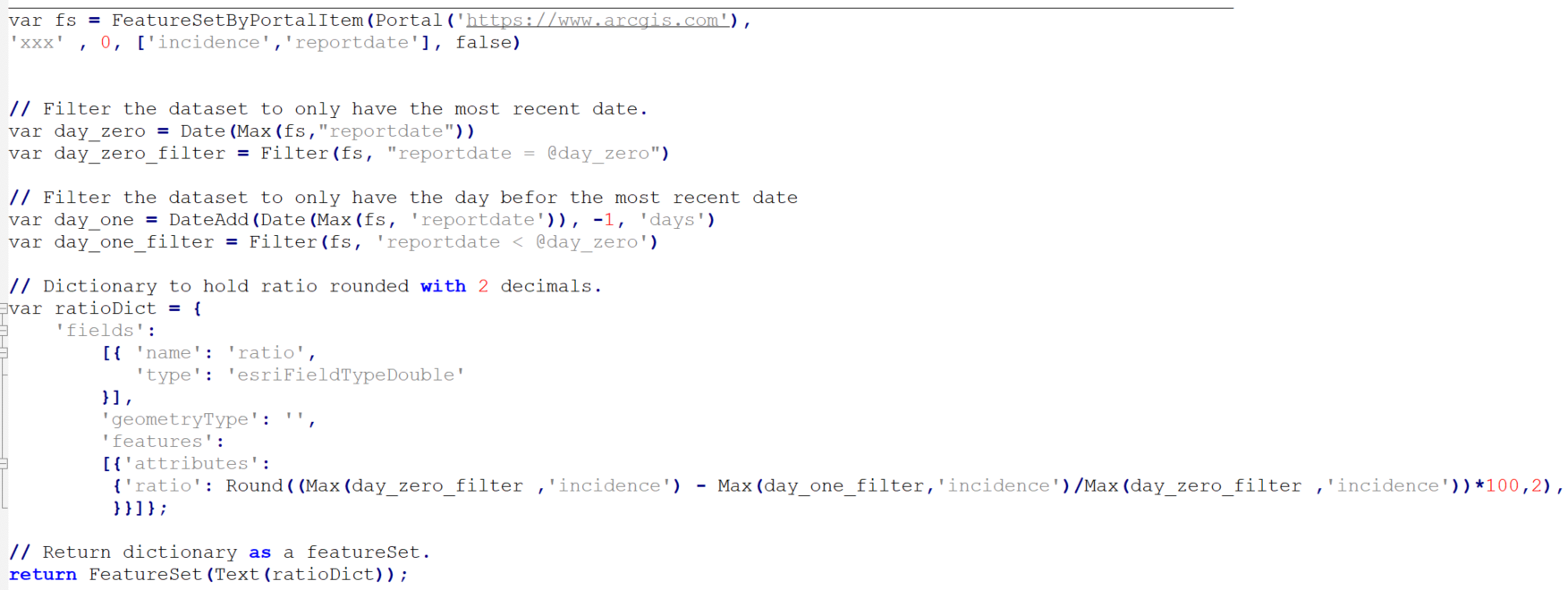

thnaks for your prompt response. I just was trying to taste the single variables and found this problem:
when I use the = sign before the @day_filter it gives me an empty result (IMG1). But the if I use > or even < it gives me a correct result (IMG2). It is so frustrating!! I also tried == but went worse ...(IMG3)
IMG 1
IMG 3

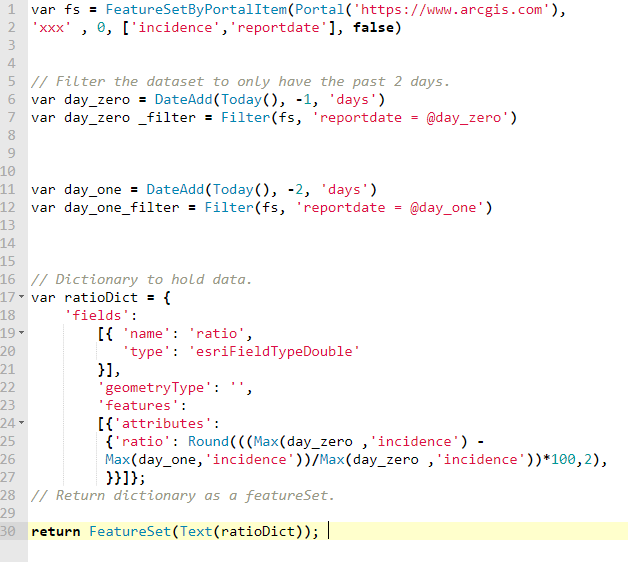

Hello Everyone,
I post here the soloution/workaround I found. I actually enden up using the Today(), becuase only with this one the = functioned.
var fs = FeatureSetByPortalItem(Portal('https://www.arcgis.com'),
'xxxxx' , 0, ['incidence','reportdate'], false)
// Filter the dataset to only have the past 2 days.
var day_zero = DateAdd(Today(), -1, 'days')
var day_zero _filter = Filter(fs, "reportdate = @day_zero")
var day_one = DateAdd(Today(), -2, 'days')
var day_one_filter = Filter(fs, 'reportdate = @day_one')
// Dictionary to hold data.
var ratioDict = {
'fields':
[{ 'name': 'ratio',
'type': 'esriFieldTypeDouble'
'geometryType': '',
'features':
[{'attributes':
{'ratio': Round(((Max(day_zero ,'incidence') - Max(day_one,'incidence'))/Max(day_zero ,'incidence'))*100,2),
// Return dictionary as a featureSet.
return FeatureSet(Text(ratioDict));
