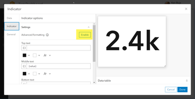

Yes, you can do this. First in the indicator tab, click the Enable button in the Advanced Formatting section.
Next, make these changes to the Expression. You'll be adding the code and uncommenting the bottomText properties.
