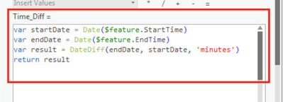

This support article should help you with the conversion from string field to date. Then you can use DateDiff to calculate the number of days between the 2 dates.
