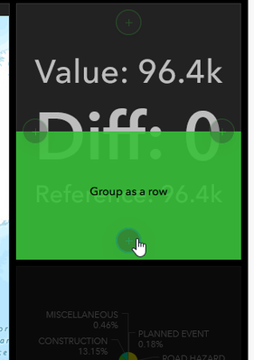

Hi,
I am able to  configure dashboard in which I can have list and indicators as separate widgets. Instead I would like to visualize them as an integrated list in which indicators are also displayed at the top. Please refer to the link.
Similar to link given below. Can I use only html for such customization
https://www.arcgis.com/apps/dashboards/81022f968ab64da983a6e20105e89965
I am using version 10.9
Thanks a lot.
jcarlson
MVP Alum
In the linked dashboard, those are actually all separate widgets. When you drag a widget to reposition it in your dashboard, hold the shift key. This allows you to group the widgets. When your dashboard is viewed, the grouped widgets will appear integrated as in that other dashboard.
