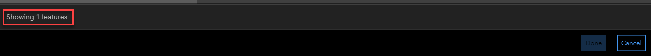

In my Gauge and Indicator Elements, they do not show the correct count values of 22 or 1, but rather they show incorrect count values of 1 and 0, respectively. However, when I say "Show data table" in the settings of both of these Elements, the data table shows the 22 and 1 features that should be reflected correctly as counts (see example screenshots below).
