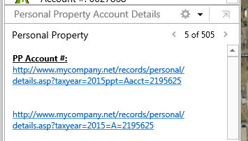

I am using Operations Dashboard with Portal for ArcGIS. When I create a hyperlink in the Feature Details widget, every time I use the '&' symbol, the widget refuses to accept the hyperlink. If I display the entire hyperlinked url and then go back and type in each '&' symbol then the letters after the symbol and before another symbol are removed in the details display. The widget does not have a problem with the '?' or '=' symbols.
For example this:
Changes to this:
Any assistance will be appreciated. I have used hyperlinks many times but never before have run into this particular problem.

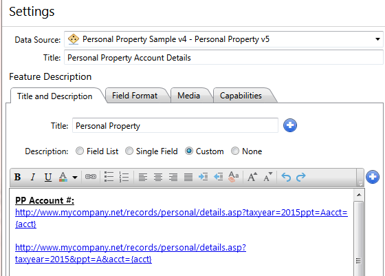

I have been doing more research and have discovered the use of '&' in HTML for hyperlinks needs to be modified to & . I have made the change but now the url is taking out the '&' in the browser so the page still cannot be reached.
For example this:
Becomes this:
Which results in this and no valid webpage:
TiffanySelvidge1
In addition to the url not including the '&'s when the hyperlink is clicked, an error message is appearing in the browser:
