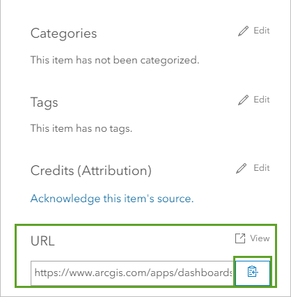

Another thing you can do, if you still find people are prompted to log in, is to use the URL from the dashboard's Item Description page, in the lower right section.
and use that in your iframe code.
This URL doesn't have your organization's name and maps in it, which helps avoid the login prompt (which may be a setting of your organization).
