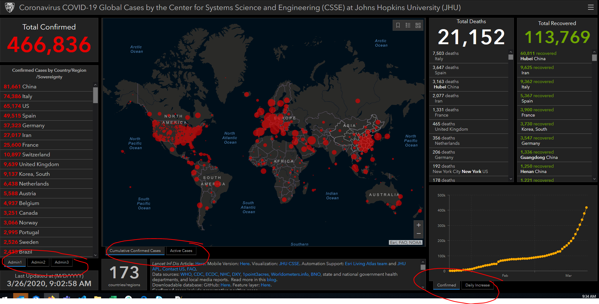

Hey Ronald Sheaks‌,
ArcGIS Dashboards allows you to stack the widgets. You can see an example of this here:
Operations Dashboard for ArcGIS
I've attached a short video as it was easier than trying to explain it!
