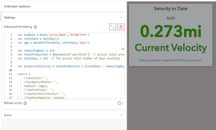

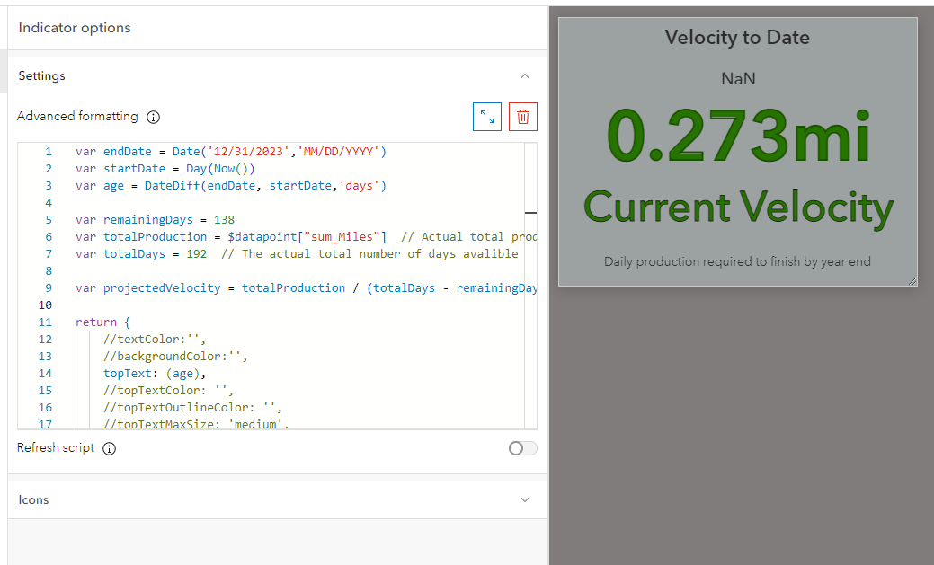

I'm building an indicator in dashboard. What I would like to show is the current velocity & the velocity required to finish by year end in 'mi'.
I've got the current velocity working, sort of. In order to keep that working and get the the second velocity working I need DateDiff to work with manually entered dates. All the examples I see link it to date fields in the feature using $feature, but for this purpose those dates are irrelevant.
The 138 is my remaining working days and that is currently manually entered, thus I need the var age to generate this number instead. (var remainingDays = 138) You can see father down (age) is showing the NaN in topText:
I my project started 3-27-23 and times out 12-31-23. I'm wondering if the problem is the output format of the Date vs Day(Now()).
See screenshot for context.
var endDate = Date('12/31/2023','MM/DD/YYYY')
var startDate = Day(Now())
var age = DateDiff(endDate, startDate,'days')
var totalProduction = $datapoint["sum_Miles"]  // Actual total production to date
var totalDays = 192  // The actual total number of days avalible
var projectedVelocity = totalProduction / (totalDays - remainingDays)
return {
    //textColor:'',
    //backgroundColor:'',
    topText: (age),
    //topTextColor: '',
    //topTextOutlineColor: '',
    //topTextMaxSize: 'medium',
    middleText: Round (projectedVelocity,3)+"mi",
JohannesLindner
MVP Alum
Your startDate isn't a date, because you're extracting the current day...
You can also use Today() instead of Now() to get full days.
var startDate = Today()
Have a great day!
Johannes

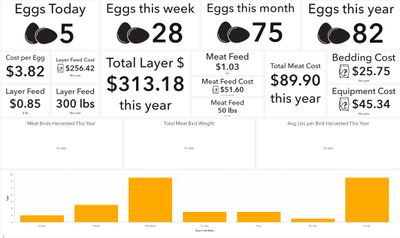

Sorry. Yes, a Dashboard. I was trying to use your Arcade expression since it does something similar to what I am trying to do. I am trying to make an Indicator that tracks how old my chickens are for butchering. I have an attribute field for the date the chicks hatched and want to keep track of their age and butcher around 8-10 weeks old. Then I will log the data using my QuickCapture app and see the weight, cost and dates for tracking production. I was hoping to use a Gauge to act like a fuel gauge and reach full when they are done.
I tried creating the date variables and pulling the date field from the $datapoint but didn't have any luck. I'm still trying to learn Arcade. Thanks for the help.

Here's my QC app.

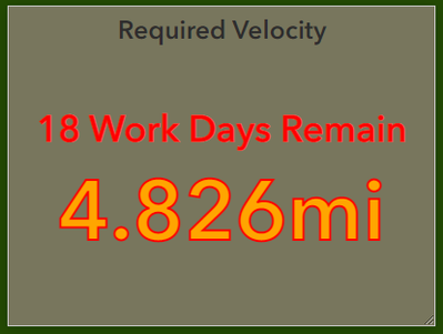

Wanted to bring this one home for everyone here.
To complete the indicators I needed to exclude the company holidays and weekends. This was being achieved through a manual entry above, but I wanted it scripted.
I worked with one of great folks at Esri, Paul Barker who gave me a direction to go, then took what I made and actually made it work. I was using normal dates, not starting at month 0, and attempting a for loop, but his 'while' statement looks so great, and is easier to get my head around.
What it does: Divides production / working days, by removing non-working days to create project velocity, and shows you the remaining days to the deadline. To create the actual velocity, just flip flip the initial variables.

return {
  //textColor:'',
  topText: (counter)+" "+"Work Days Remain",
  topTextColor: 'red',
  topTextOutlineColor: 'red',
  middleText: Round (requiredVelocity,3)+"mi",
  middleTextColor: 'orange',
  middleTextOutlineColor: 'red',
  middleTextMaxSize: 'medium',
  //bottomText: '',
  //bottomTextColor: '',
  //bottomTextOutlineColor: '',
  //bottomTextMaxSize: 'small',
  //iconName:'',
  iconAlign:'left',
  iconColor:'Orange',
  iconOutlineColor:'red',
  //noValue:false,
  //attributes: {
    // attribute1: '',
    // attribute2: ''
Thanks Paul!
