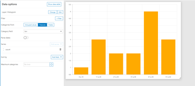

What you're describing is a histogram, which is sort of a different animal from the serial chart. It's something others have expressed an interest in as well.
Fortunately, with the latest updates to Dashboards, you can use a Data Expression to create what you need. Try something like this:
var fs = [2,12,24,36,48,55,6,16,26,36,46,12,7,18,12,41]
// static list is for testing; use FeatureSetByPortalItem to get the actual values
var bins = {
    '0 to 10': {'attributes': {'bin':'0 to 10', 'count': 0}},
    '11 to 20': {'attributes': {'bin':'11 to 20', 'count': 0}},
    '21 to 30': {'attributes': {'bin':'21 to 30', 'count': 0}},
    '31 to 40': {'attributes': {'bin':'31 to 40', 'count': 0}},
    '41 to 50': {'attributes': {'bin':'41 to 50', 'count': 0}},
    '51 to 60': {'attributes': {'bin':'51 to 60', 'count': 0}}
for(var f in fs){
    if(fs[f] < 11){
        bins['0 to 10']['attributes']['count'] ++
    } else if(fs[f] < 21){
        bins['11 to 20']['attributes']['count'] ++
    } else if(fs[f] < 31){
        bins['21 to 30']['attributes']['count'] ++
    } else if(fs[f] < 41){
        bins['31 to 40']['attributes']['count'] ++
    } else if(fs[f] < 51){
        bins['41 to 50']['attributes']['count'] ++
    } else{
        bins['51 to 60']['attributes']['count'] ++
var feat_arr = []
for(var b in bins){
    Push(feat_arr, bins[b])
var out_fs = {
    'fields': [{'name':'bin', 'type':'esriFieldTypeString'},
               {'name':'count', 'type':'esriFieldTypeInteger'}],
    'geometryType': '',
    'features': feat_arr
return FeatureSet(Text(out_fs))
This results in the following:
As you can see, Data Expressions can be very handy, if built properly. Best of luck!
