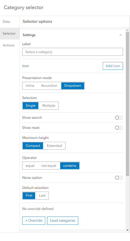

Tiff
You should be able to do this using the "Operator" section in the category selector (within the Selector tab). You would likely have to override the categories below that to specify "Owned" as an option.

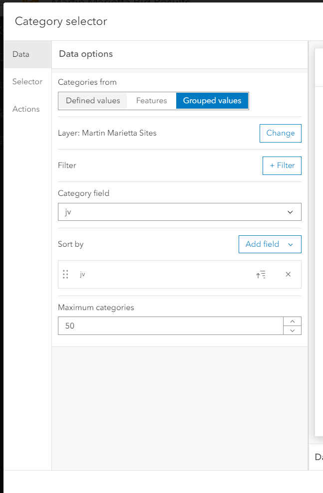

JonJones1
Hey! When I choose "Operator," nothing appears for me to enter my desired text. Please see how I have it set up. Also, "jv" is actually the field that contains my keyword of interest.  Any thoughts? 1.png2.png

Tiff
Where it says "No override defined", you should be able to "Load categories" first to see what comes up (should be all the values) and then you can Override it and put "Owner" as an option.
