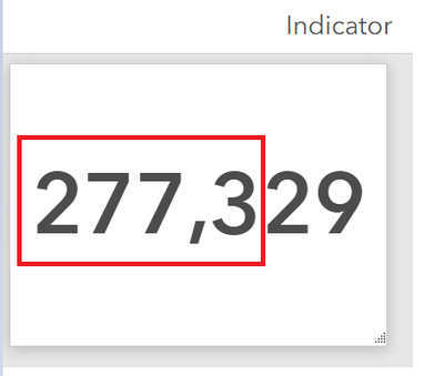

I'm in the process of creating a new dashboard and trying to show a length of an asset, however, the figure in the indicator shows all decimal numbers where I only wanted to show 4 digits (and will add a suffix to be as a KM), as the below screenshot:
Any thoughts on how to minimize the digits numbers?

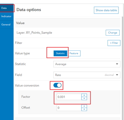

Please check if the following tweaks to the indicator works for you?

Could you share a few more details/ clarification on the data values?
- Is the comma denoting a decimal point (like denoting 277.329) or a Thousand Separator (like denoting 277329 meters)?
- What is the range of values you have for that attribute.
- If it's a thousand separator, would you like a suffix of "m" for values upto 999.9, and convert them to km once its reaches 1000 m mark?

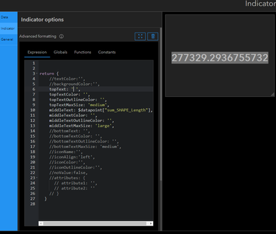

Please find the below screenshot where I'll explain your queris. I'm actually not much familiar with Arcade, but you may guide me through the process.
I have the length number as shown below (277329.2936755732), so this long number is in meter, and I want it to be presented in kilometer formate like (277.3 KM) only to have 4 digits. What function do I need to add to the Arcade?

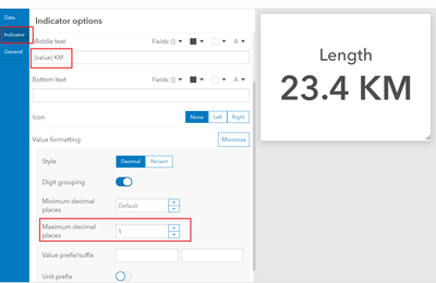

Think Location
Abdullah_AlFazari
Hi @JayantaPoddar
You are awesome man, this is splendid and worked with me. Thank you very much for the great support.

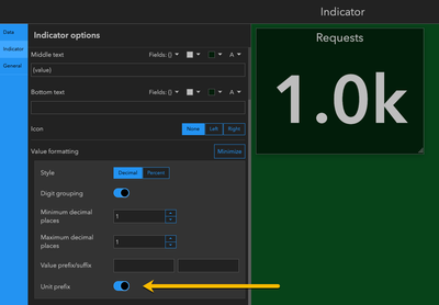

Are you looking for unit prefixing?
Here is a link to do it if using advanced formatting (via Arcade).
