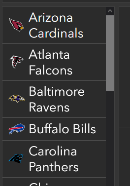

On the far left side there is a list of different teams and as you click on each, a filter is applied to other elements of the dashboard such as pie charts, and lists.

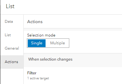

How was that filter list created in the example?  What type of dashboard element is this?  My web map feeding the dash has a single feature class with a names field that I'd like to use as a filter - similar to the team name in the example.

In the list that you want other elements to be filtered, you need to assign the source and target fields from the Actions tab. In all other elements, there should be a shared field that you want to filter data according to that.
