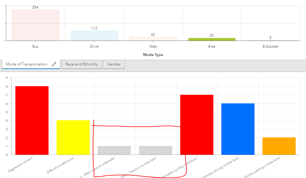

Hello,
I am trying to aggregate all answers which user choose other and type his/her respond on the box in survey123. I just want to show how many other respond but I don't want to see actual answers.
you can see below a screen shot which i couldn't find the way and I just want to have one bar for all other together.
I have this arcade code which group each respond but I don't know how can I add other to.

I would assume from your post that this is coming from a survey? How are these "other" values getting into the `neighborhood` field? Are you concatenating choices from the survey?
Anyway, we can group all the "other" responses by using a list and matching against it. The Data Expression examples have yet to be updated to include this, but recent updates to the Arcade language enable us to use Push to populate an array, rather than using an index variable.
Try something like this:

Do note, however, that the final "GroupBy" isn't necessary if the chart is all you need this for; the chart can handle the summing for you.
