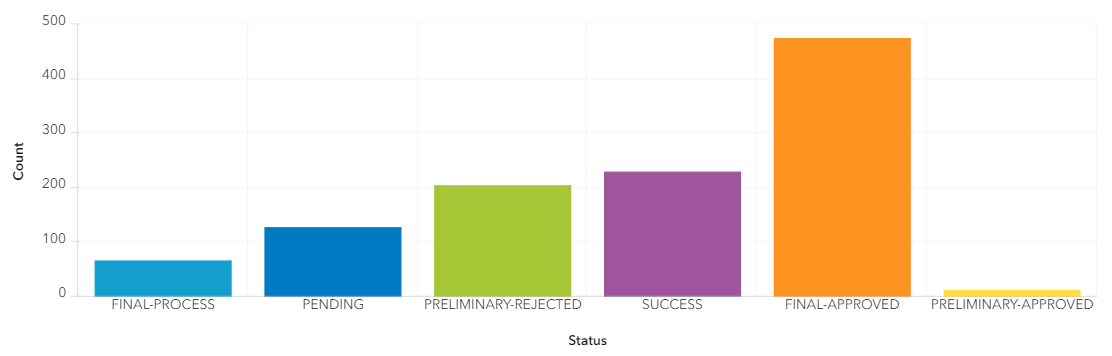

I have configured a dashboard where one of the elements is a bar chart of count of application status. Please see screenshot below.

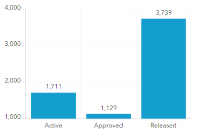

However, I want to group these statuses to only 3 groups: Active, Approved, and Released in the DASHBOARD LEVEL. Please see screenshot of preferred output.

In a Data Expression, you can use the GroupBy function with a case expression in the SQL statement to return a FeatureSet with a calculated field. It would look something like this (not knowing how you want the original statues reclassified)
var fs = FeatureSetByPortalItem(
  Portal("your portal"),
  "itemID",
  0,
  ["Status"],
  false
var sql_statement = `CASE
WHEN STATUS = 'PENDING' OR STATUS = 'FINAL-PROCESS' THEN 'Active'
WHEN STATUS = 'FINAL-APPROVED' OR STATUS = 'PRELIMINARY-APPROVED' THEN 'Approved'
WHEN STATUS = 'SUCCESS' THEN 'Release'
ELSE 'Other'
END`
GroupBy(
  fs,
  { name: "Status", expression: sql_statement, statistic: "COUNT" },
  { name: "Total", expression: "1", statistic: "COUNT" }
