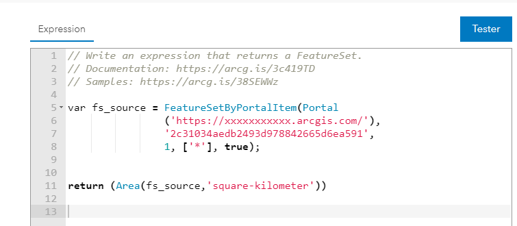

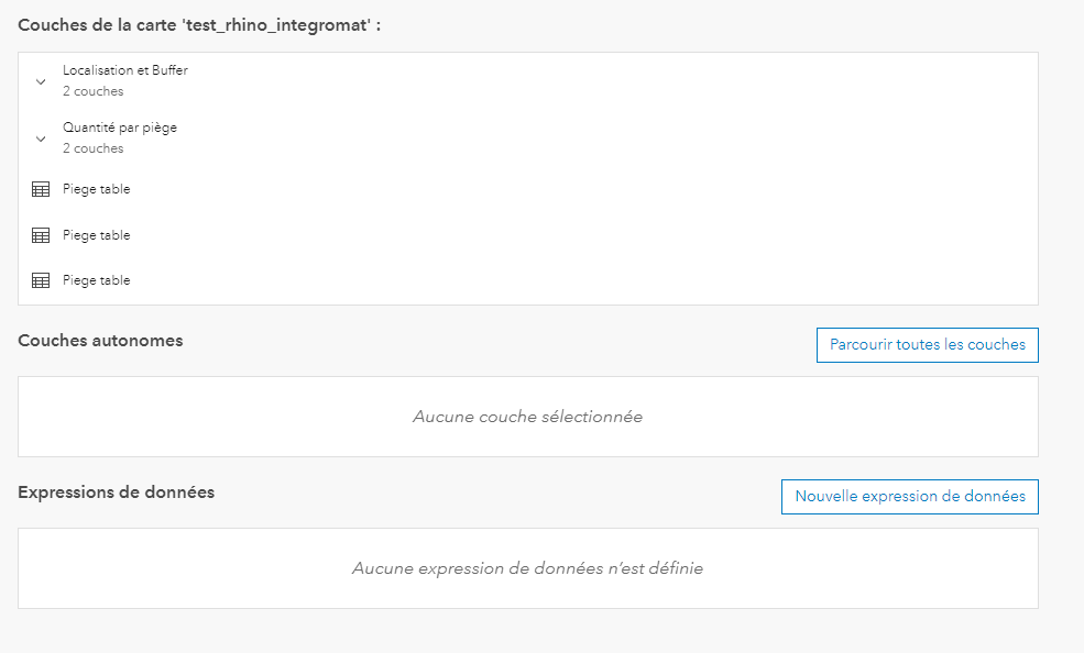

I work with a dashboard, I would like to perform geometry calculations with « New data expression » Arcade.
 I used to work with « New data expression », for attributes values, but this is the first time with geometries.

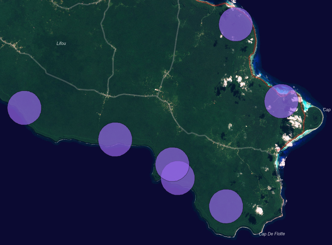

From this example below:
I know how to calculate the total area. But I don't know how to write the code to get the area without polygon overlap.
Can someone help me?

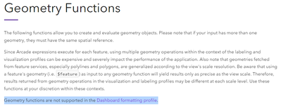

The first screenshot that you showed is of an Arcade Data Expression and this is not using the Data Formatting profile which is limited in what it can do.
So in short, I think it should be possible to do what you want to accomplish.
