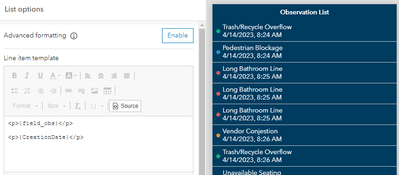

Format list to show how many minutes ago a point was created
1627
6
04-14-2023 11:50 AM
dwold
I have a list and I want to display how old or how long ago a point was created. Is there a way to write this out so the list reads with the Incident and below it says: Occurred X Hours X Minutes ago

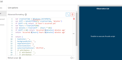

dwold
@KenBuja thanks for your help with this. Did I input this correctly? I'm not to the advanced formatting section.
KenBuja
MVP Esteemed Contributor

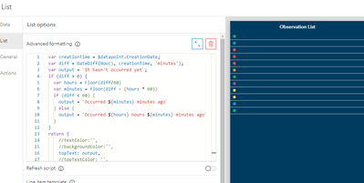

My apologies, this was tested in the Playground, not an indicator. Give this a try
var creationTime = $datapoint.LASTUPDATE;
var diff = DateDiff(Now(), creationTime, 'minutes');
var output = `It hasn't occurred yet`;
if (diff > 0) {
  var hours = Floor(diff/60)
  var minutes = Floor(diff - (hours * 60))
  if (diff < 60) {
    output = `Occurred ${minutes} minutes ago`
  } else {
    output = `Occurred ${hours} hours ${minutes} minutes ago`
return {
    //textColor:'',
    //backgroundColor:'',
    topText: output,
    //topTextColor: '',
    //topTextOutlineColor: '',
    //topTextMaxSize: 'medium',

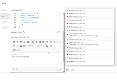

dwold

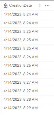

@KenBuja Getting closer...I think. Not knowing much about arcade expressions, is having the date with the time causing an issue?
Attribute table:
KenBuja
This was tested in a List
if (diff > 0) {
  if (diff < 60) {
  } else {
return {
  textColor: '',
  backgroundColor: '',
  separatorColor:'',
  selectionColor: '',
  selectionTextColor: '',
   attributes: {
     elapsed: output
In the Line item template section, add in "{expression/elapsed}".
This is what my testing List looks like:
dwold
@KenBuja That worked! Thank you s much for your help, I appreciate it!
