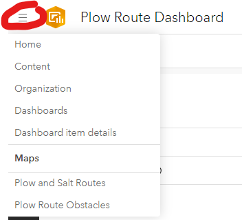

It's not an intuitive spot at all, but if you click the three lines to the left of the Dashboard header, it lists the maps you have in your dashboard and you can click on them and it will navigate you to the map in your portal:

For others looking at this solution, if it helps, note my interface looks slightly different:
