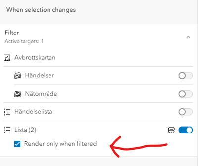

What you would like to do, to have the user select from a list of available values, is possible with a category selector, or with a list with actions configured, as you have tried in your example. However, these options only allow filtering on one field, not multiple. The solution then, is to alter your data schema, e.g., like below. Then you can have a list with all unique values that filters column Focus Area in the second table below. If you configure the final list to show only when filtered, the end user will not understand that you have duplicate data in your dashboard.
